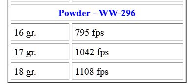

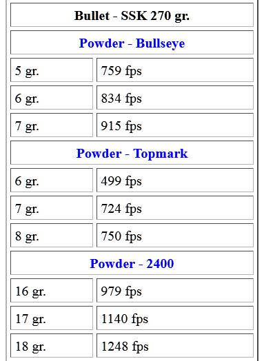

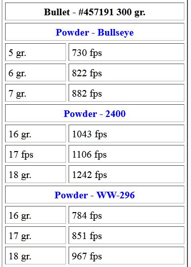

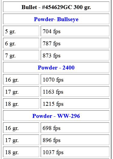

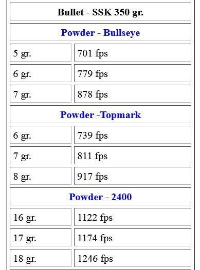

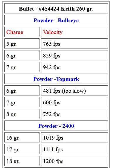

Some years ago I got wondering how well the slow twist of the .454 Casull would handle mild velocity with heavy bullets. I knew they were accurate at high velocity, but what about when you slowed them down? I loaded up a bunch of loads with the .300 gr. #457191 Lyman bullet, the 300 gr. #454629GC bullet, the SSK 270-451 270 gr. bullet, the 260 gr. Keith #454424 bullet, and the SSK 345-451 350gr. bullet. I ran them from 700 fps and up. What I found was that all except the 350 gr. bullet were stable at low velocity. The 350 gr. bullet showed signs of yawing until I got it up around 900 fps. At just over 1000 fps I fired groups under 1" at 25 yards with it - some as small as 5/8" center-to-center for 5 shots. These loads on the 200 yard ram were fun! You would shoot -POW- wait a bit, see the ram start to tip and then hear CLANG. At 1000 fps the big bullet has 776 ft. lbs. of kinetic energy.

All loads were fired from a 7 1/2" .454 Casull - all chronographed at 7 feet from muzzle to first screen - all loads in Federal .45 Colt cases with Federal #150 primers - temperature 70° F

The most accurate load of all these was the 350 gr. SSK bullet and 18 gr. WW-296. I would not recommend you trying any of the Topmark loads. All of the ones listed were not too accurate. Bullseye and 2400 gave better accuracy in all loadings.
