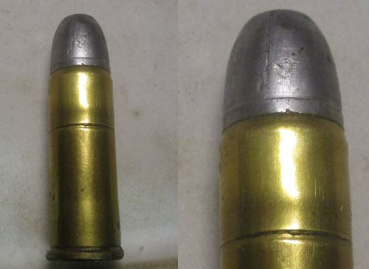

when we first started loading the 300 gr. #457191 bullet. Without case tension the heavy recoil walked the bullets out and tied up the gun.
I eventually did this with the 454 and the .475.
This is my 300 gr. .45 Colt load. You can see how the case is stretched on the bullet ..

Testing Bullet Pull
- Jim Taylor, 2023-04-01, 09:23
