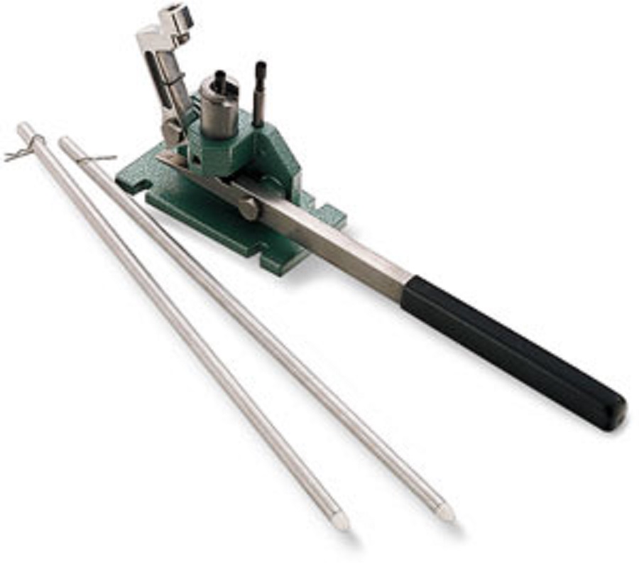

I talked to another of our Misfits late yesterday afternoon who had misfire problems. He had one of the little LEE primer seaters. The little rounds plastic gizmo. They are OK for the first 50 or 55 primers but the seating is done by your hand and after 65 or so primers you seated your hand gets tired and you don't quite seat the primers as good as they need to be.Then by 80 or so primers you are not seating them as good as they need to be at all.
I am not bad mouthing the Lee product but am mentioning the problems they cause. If you are going to use one of them, seat a few primers then set the priming unit aside and let your hand rest and then do the rest a bit later. I prefer the RCBS bench primer. I think it is called the Auto Prime.
![[image]](images/uploaded/20240509204550663d35fee6fb2.jpg)
This little gizmo lets you feel the primer seating in the palm of your hand. You can prime a couple hundred cases as quick as you can pick up a case and put it in the shell holder. I have to load every night of the week for our test firing the next day or so, so if I can give you guys some helpful hinks that is all I am doing.
