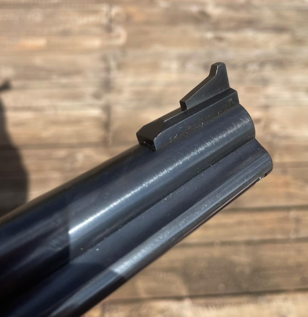

Not much concern of anyone duplicating this. A resurrected ancient (1880's contrivance) adapted to the revolver some 40 yrs. ago. However this piece dates to 2008. A few clues as to the origins of the custom work, validating that is was from the Bowen workshop. The front sight seems to be a re-milled factory Ruger with some very expertly done file work. the contours and X-Y angles are truly that of a skilled person.
![[image]](images/uploaded/2025032021092267dc8402c71e0.jpg)

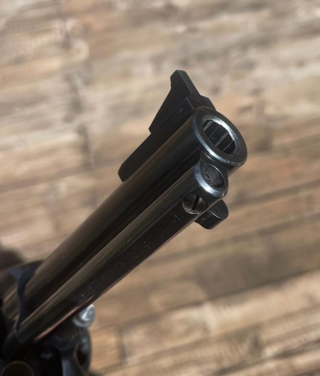

The crown is also subtle but precise. The rifling is stock .44 cal. which a 0.417" pin gauge should be the largest that will still gently slide down. However brief, I cannot yet measure the length of rifling, ahead of a smoothbore portion of reputed 0.451" diameter. As mentioned before the cylinder is straight through bored 0.480". I also note the fine touch of an expertly fitted Mountain cylinder base pin. The bore came ferociously heavily leaded. I'll need to attend to that.
![[image]](images/uploaded/2025032021100367dc842b206b9.jpg)
![[image]](images/uploaded/2025032021103167dc8447c1287.jpg)

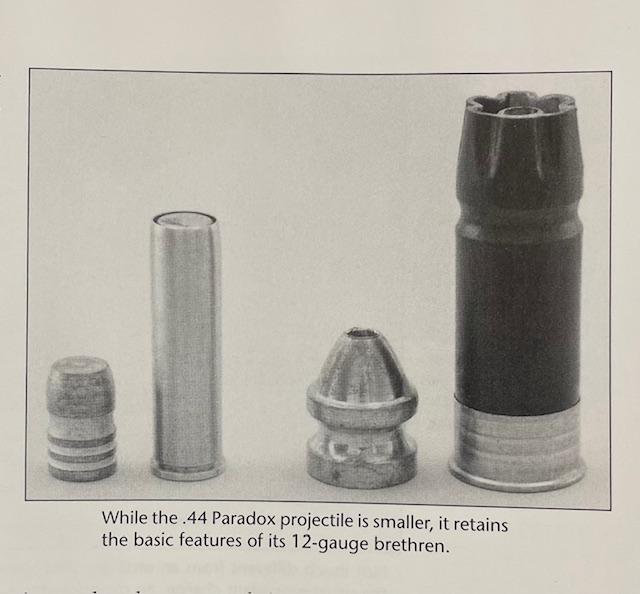

I was hunting my pin gauge set that is still at large. I'm not supposed to lift over 10 lbs. yet anyway. But I did find my Bowen Custom Revolver book. He goes way overboard in the description and history of "Paradox" arms. Certainly everything you'd need to know historically. Little tidbits as well. It was hinted that lower velocity .45 Colt loads may shoot quite well as is. However for .44 Mag. level performance it becomes more of a trick. A worthy chase.
![[image]](images/uploaded/2025032021113367dc84854fdce.jpg)
