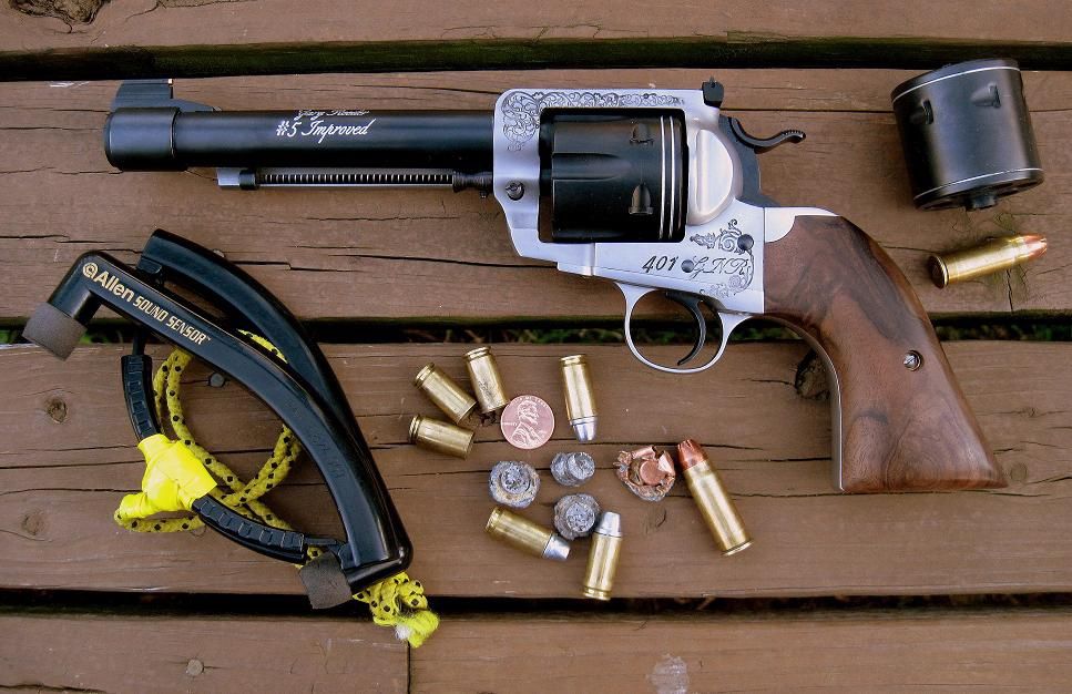

Or G2. He uses a shorter handier barrel to very notable effect. The .41 has better ballistic coefficient than a .44 mag. For ranges up to about 150 yds. it’s tough. Basically the .44 mag. necked to 410”. He has the .356 GNR (.41 necked to .358”) if you are not after game larger than deer. I own a .401 GNR that shows lots of potential. It’s the .44 mag. necked to 10mm. You can get really addicted.
He also has so much based on the .30-30 basic case. .22 up to .400 cal. My favorite is the .256 Falcon (replicates .257 Roberts performance), 7mm GNR (7x57 performance), and .30 GNR (about like a .300 Savage) that you shoot normal .30-30 to form. I really enjoy those. Good strong rimmed brass for a sturdy platform in the single shot.
Find something that strikes your fancy. Many factory produced TC barrels can manage with a simple rechamber. Some revolver applications too.
