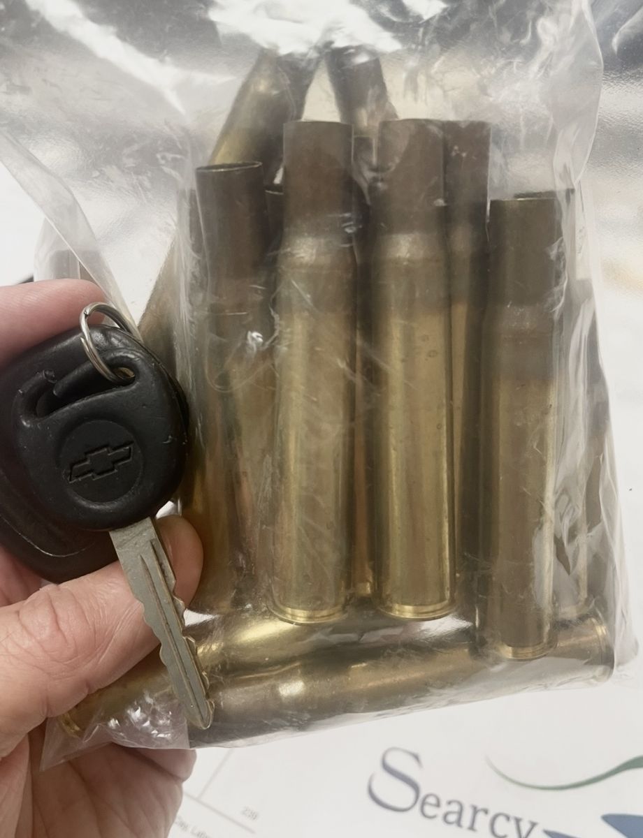

I need .500 NE 3” cases. I can go about making them from this readily available .416/500 NE. I can trim to 3” and expand. Maybe blow out as a blank then trim. But what an ear shattering violent use of bunches of pistol powder! I’ll tinker with it. I like the looks of the big, rimmed, .416! There are several larger caliber sporting rounds that did not get much press. The .370 Sako, .400 H&H, and this .416, just to name a few. A bit much for the high B.C. .22 and 6.5mm crew. lol. But when you need a big hit, you need it.
![[image]](images/uploaded/202608121540506a7c9402c66fa.jpg)
These are BIG cases! Basically .470 NE necked to .416

- I’m just trying to make .500 NE cases on the cheap - WB, 2026-08-14, 08:53

Have you tried making 9.3x74R into 405 Win cases (nm)
- Sean Harper, 2026-08-12, 14:35
- Should work, you can make short from .30/40 Krag - WB, 2026-08-12, 17:44
