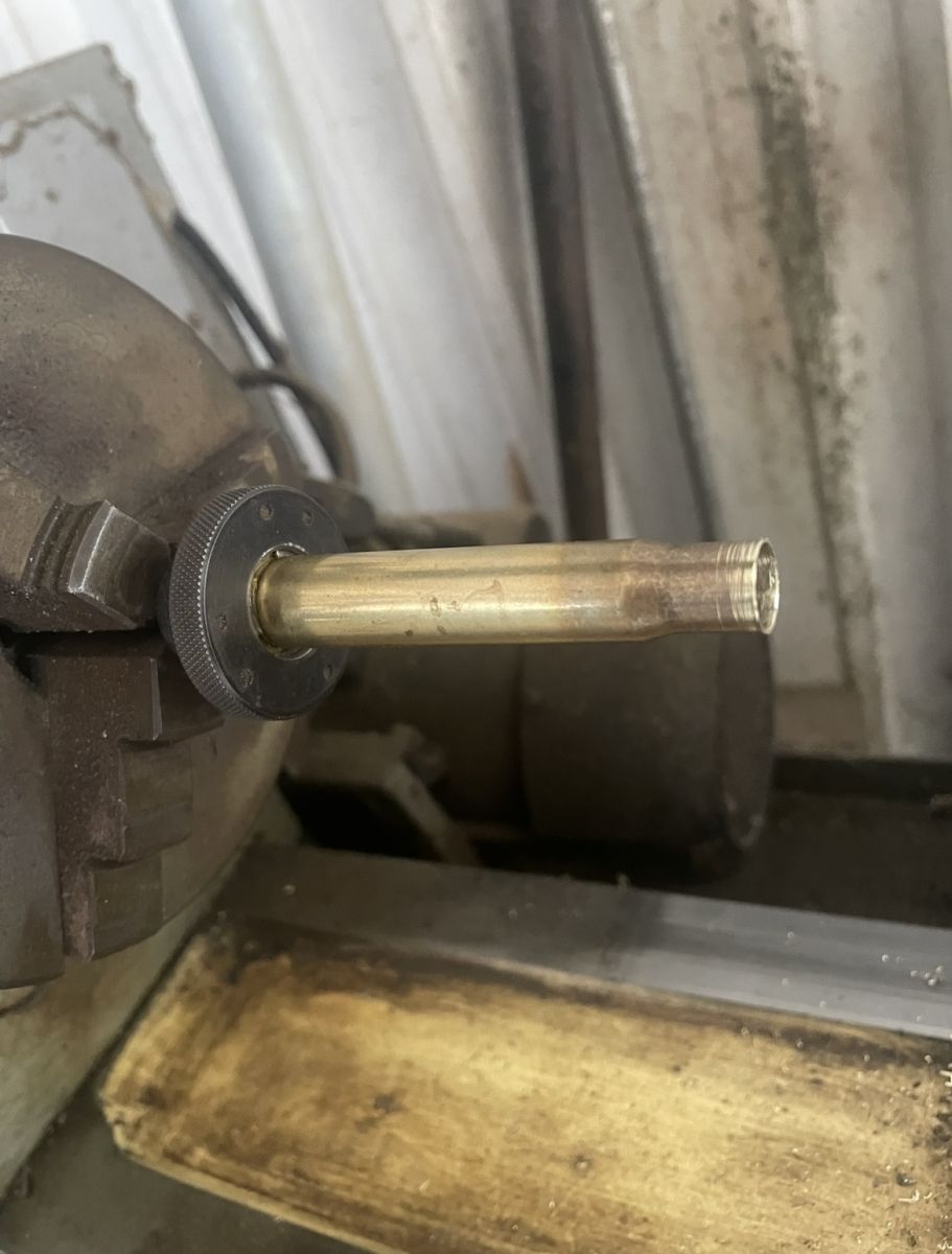

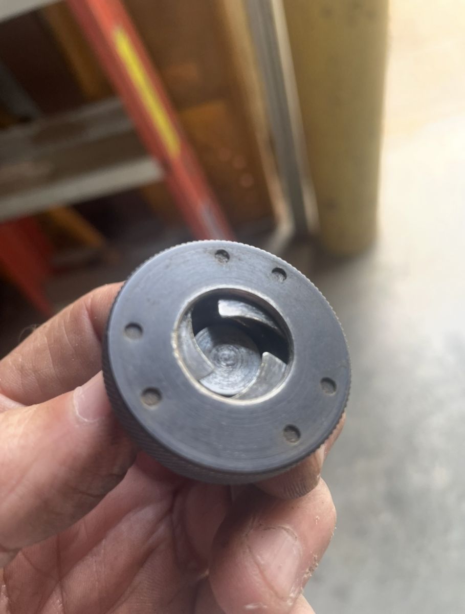

I quickly found the LEE collet case holder was never intended to house humongous 0.650” rims. Well….it is a lathe. So with Dick Lee readjusting in his eternal garden, I adjusted the limits of the mass marketed engineering. Slaloming on the glass now!

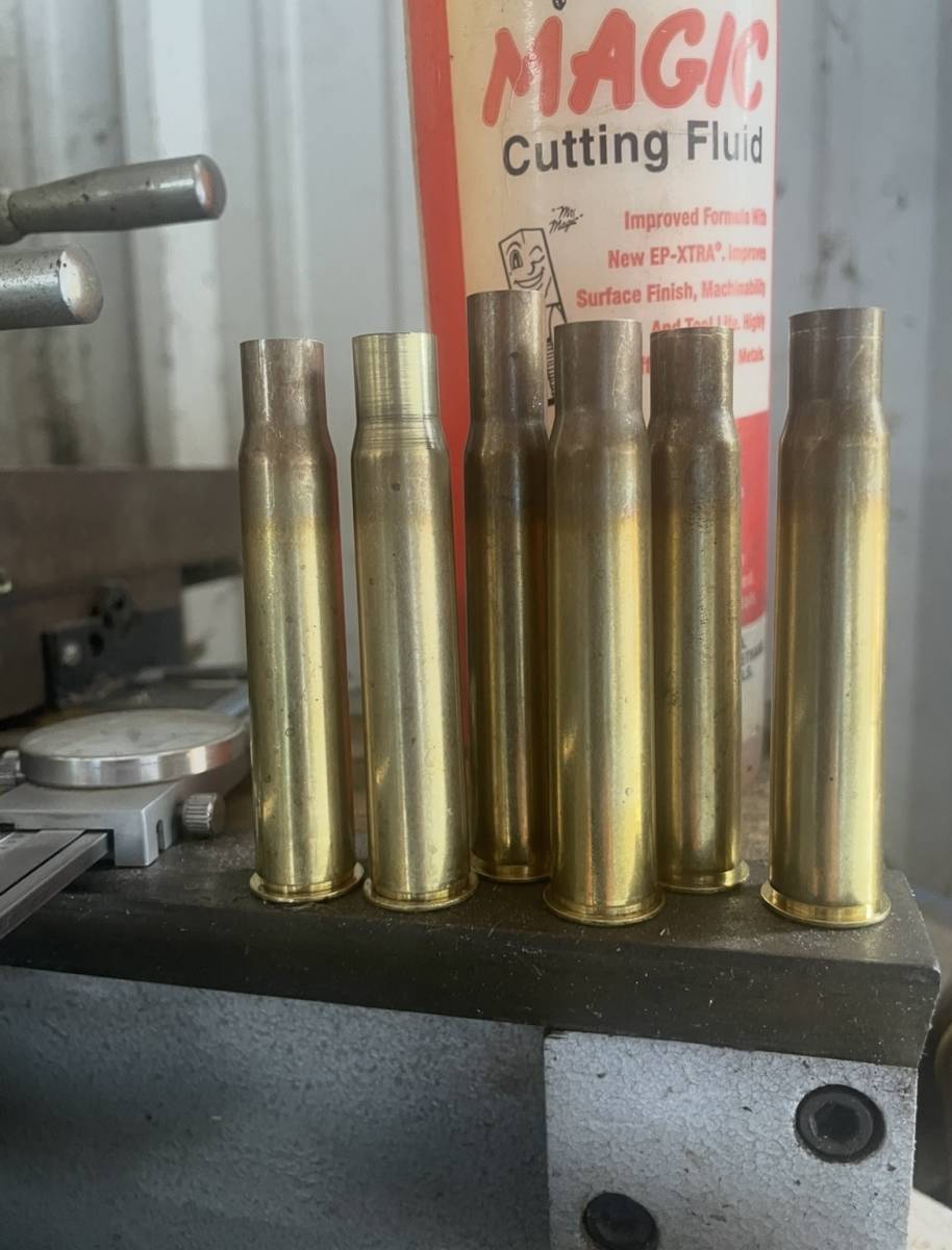

I decided to try trimming to 3” and ball expanding first. A trial (5). Looks to be nice resilient thick and long lasting brass.

These are BIG cases! Basically .470 NE necked to .416

- I’m just trying to make .500 NE cases on the cheap - WB, 2026-08-14, 08:53
