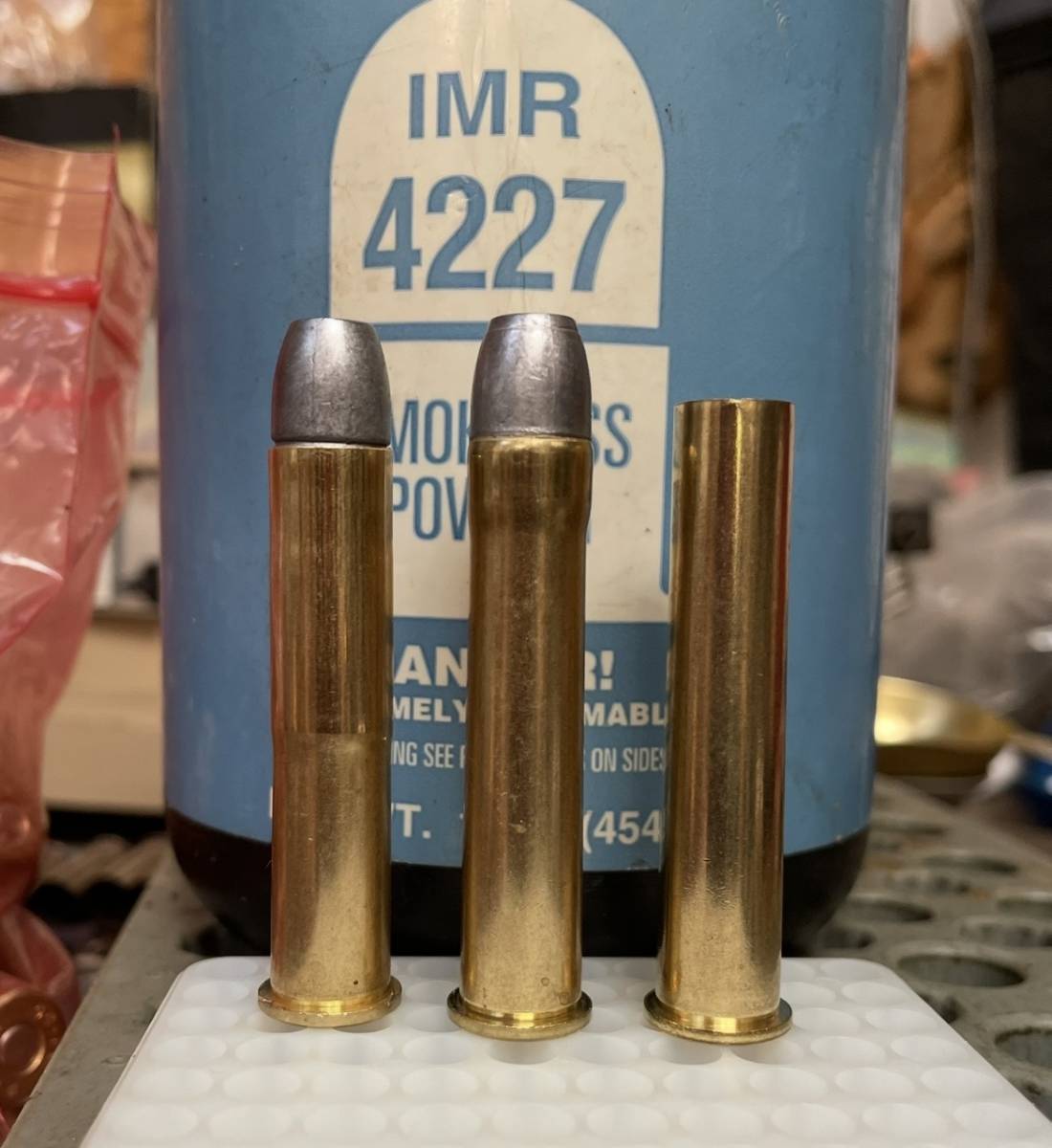

I shot some of them in my Contender. The 2.08” or so cases need a bit of trimming to get closer to the 1.97” spec. for the .400 GNR. Rather than .30-30 brass this is thin wall .38-55 Win. Should have an easier time allowing cast bullets of proper size. The .30-30 cases are all over on thickness at the case mouth. Usually they run 0.008-0.011”, the .38-55 are 0.006-0.007”. Irv has a custom .400 GNR Marlin. We have (100) rnds. to work with.
The one on the left I used an elliptical .415” sizer ball but it took lots of pressure to expand the walls. Then I sized back down to .400 GNR (10mm). But I think letting the gasses work on these new virgin cases is the best way. It works them less.

Trimming ant trying to load up .400 GNR for Irv

They look goofy but the charge should fire form, blow out.
