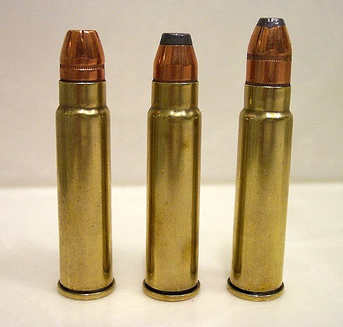

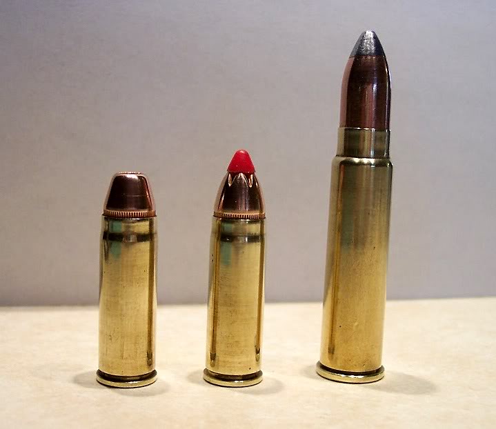

.440 compared to .429 GNR loads, about a 400 fps advantage.

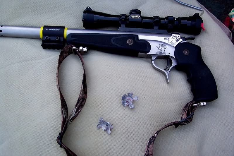

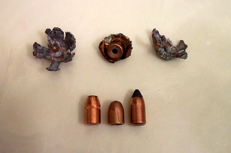

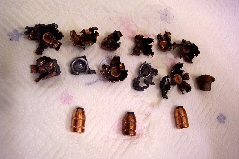

Three hammered copper hacket SP 300 gr. @ 2300 fps. A 300 Gr. JHP and .45 ball slug for reference.
![[image]](images/uploaded/2017032423112558d5a79d28321.jpg)

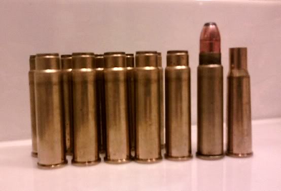

Blank fireformed cases using AA#7 in .348 cases. Trim about 1/10" and done.

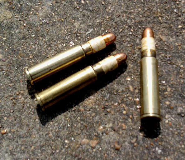

Custom Grizzly safety loads. Paper patched .430"/.416-400 gr. loaded to 1900 fps.

What is the yellow under the clamp-on rail? (nm)
- DinCA, 2017-03-24, 20:04
I'd guess . . . yellow duct tape, ;-) (nm)
- ORG, 2017-03-24, 21:22
- Electric plastic tape so no scratches also - WB, 2017-03-25, 06:14
