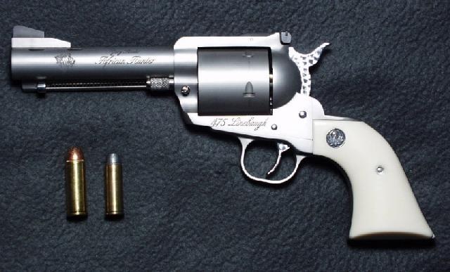

![[image]](images/uploaded/201801041534465a4e4996784c4.jpg)
This was a pic from the GunsAmerica add where I bought my very first Reeder Custom .475 LB. It was beastly in this configuration.

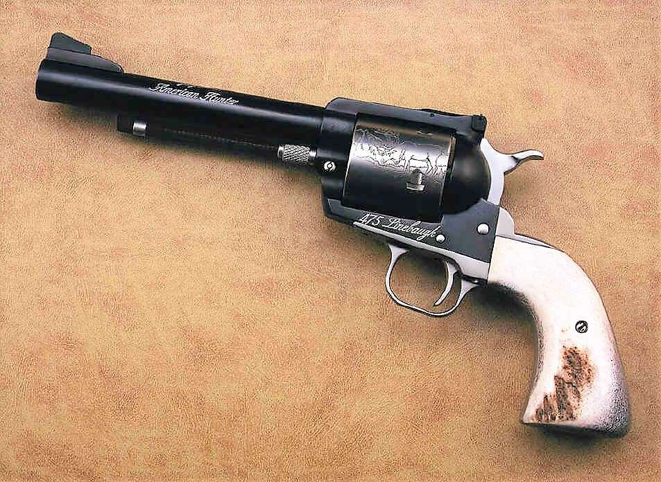

![[image]](images/uploaded/201801041532235a4e49070a238.jpg)
A bit more refined, I've always lusted for Stonecold's .475 American Hunter.

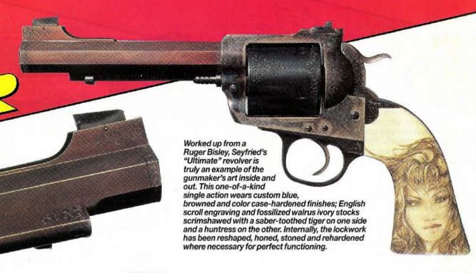

![[image]](images/uploaded/201801041533205a4e4940cb5d4.jpg)
Another look at the .475/480 vs .500s
