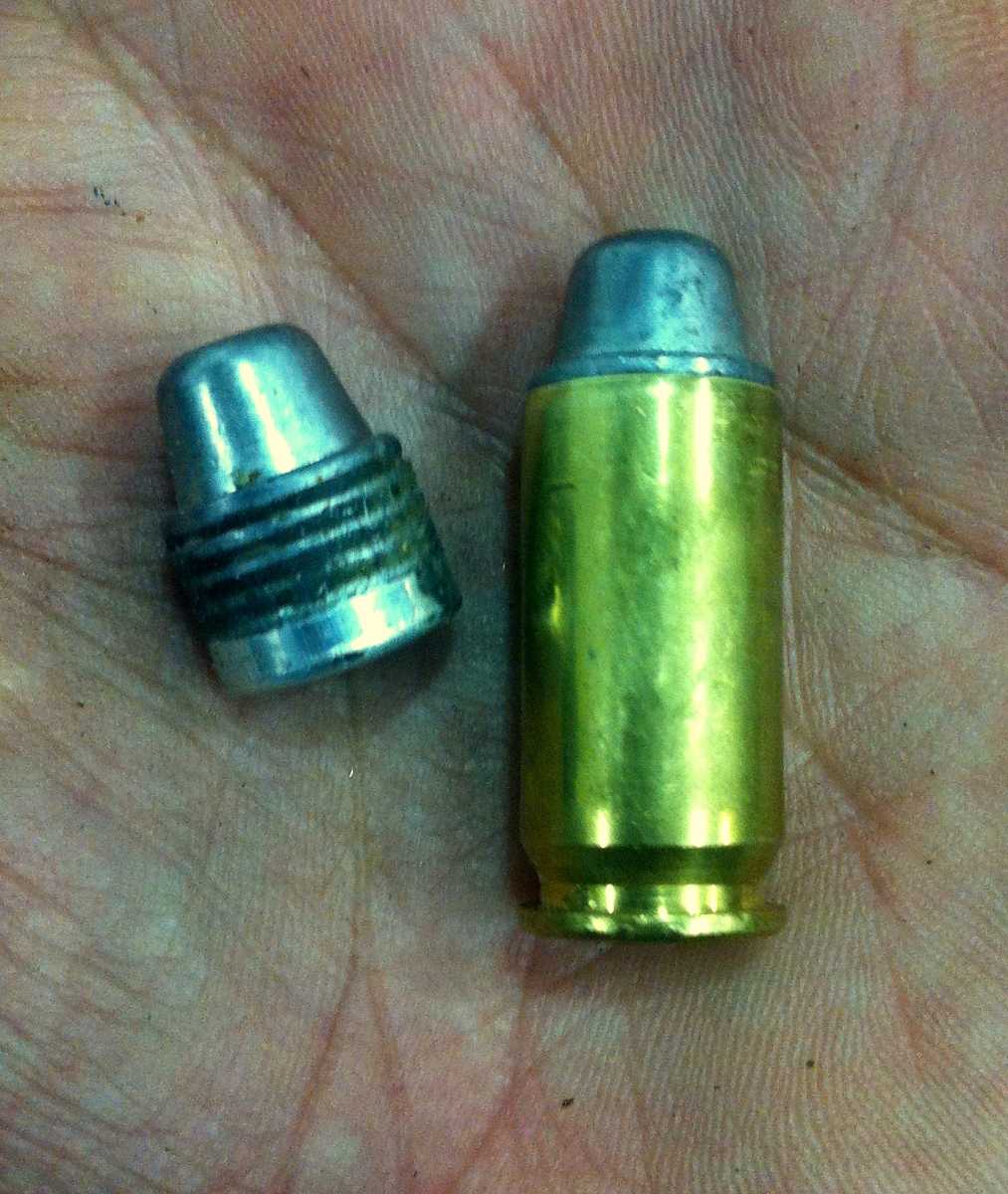

The odd 200 gr. SWC "PB" gas check bullet. Slick, and fast, hits hard, a softer alloy mix would give some expansion if I wanted it. *I'm headspacing some off the extractor, keep it quiet.

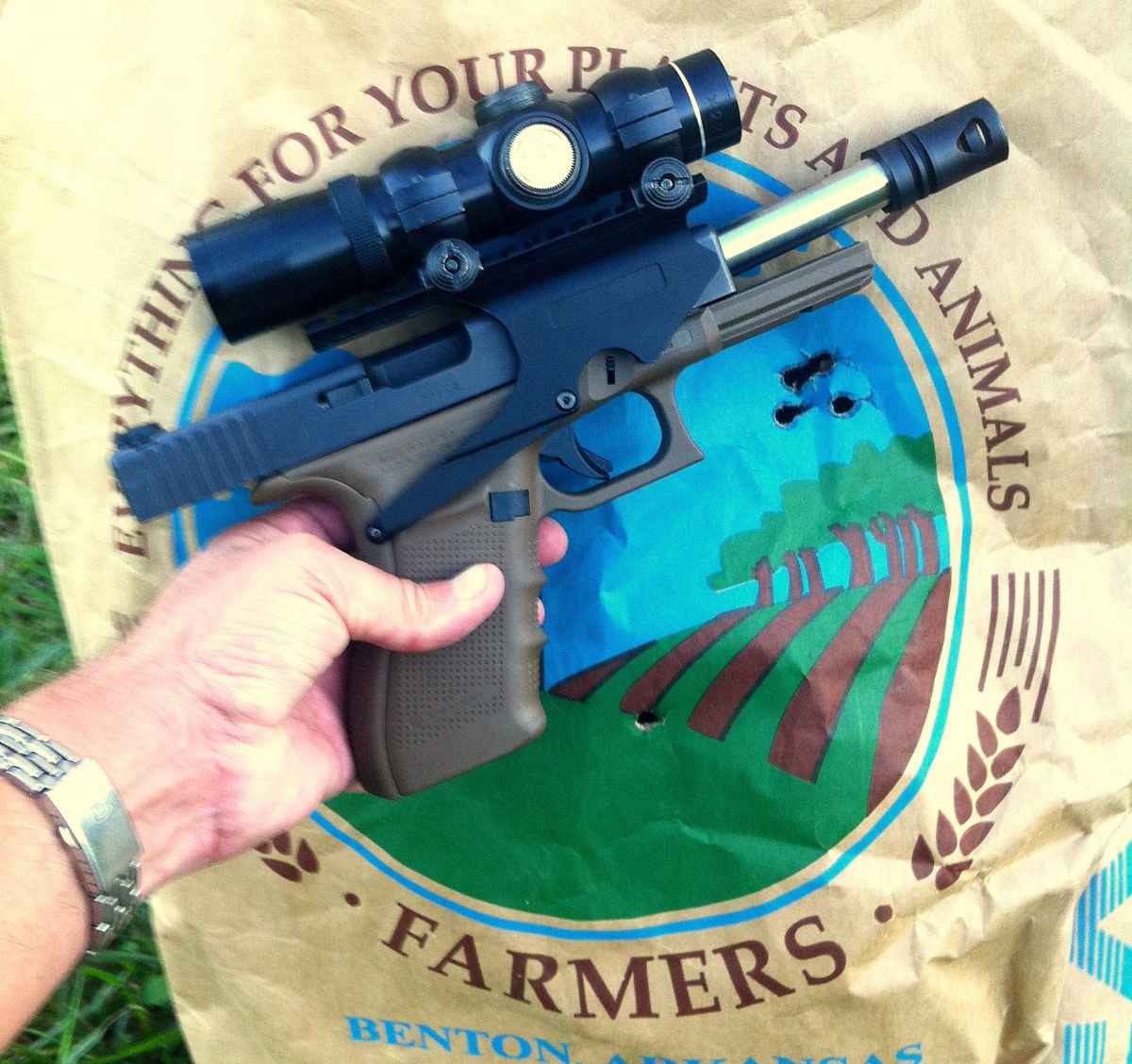

I tried a scope mount and it worked great for a short time. The front pin bent and the frame flexed rubbing a small mark on the top of the slide. The thing shoots though, this was 33 yds. I'm a little scared of those slide mounted optics, but they are light enough it wouldn't hurt too bad if it hit you in the face. I might try one.
