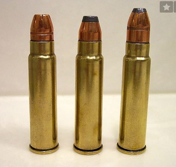

Freshly formed to my chamber from .348 blanks. You can see what needs to be trimmed. The brass was into the throat a little, that's what I trim back. 50 AK brass is shorter and this does not happen, it's simply necked down in the FL die.
![[image]](images/uploaded/201805221828205b04614435342.jpg)

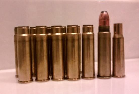

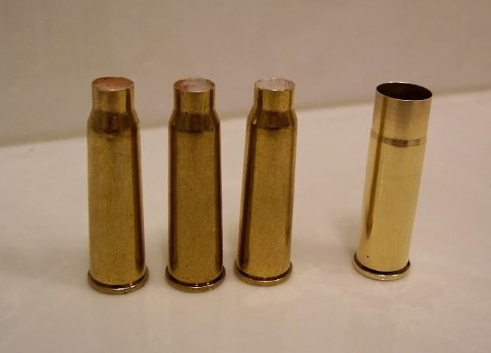

Same principle applied to the .50-95 Win. I cut the necks half off first, then fireform with a blank.
![[image]](images/uploaded/201805221829535b0461a1a107c.jpg)

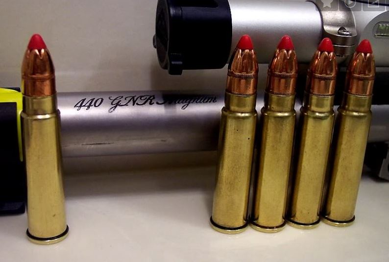

I took my .440 GNR handgun to AK for Black Bear, and I'd do it again. I was trying to choose a Black Bear bullet, all worked fine.
![[image]](images/uploaded/201805221832515b046253ad00c.jpg)
