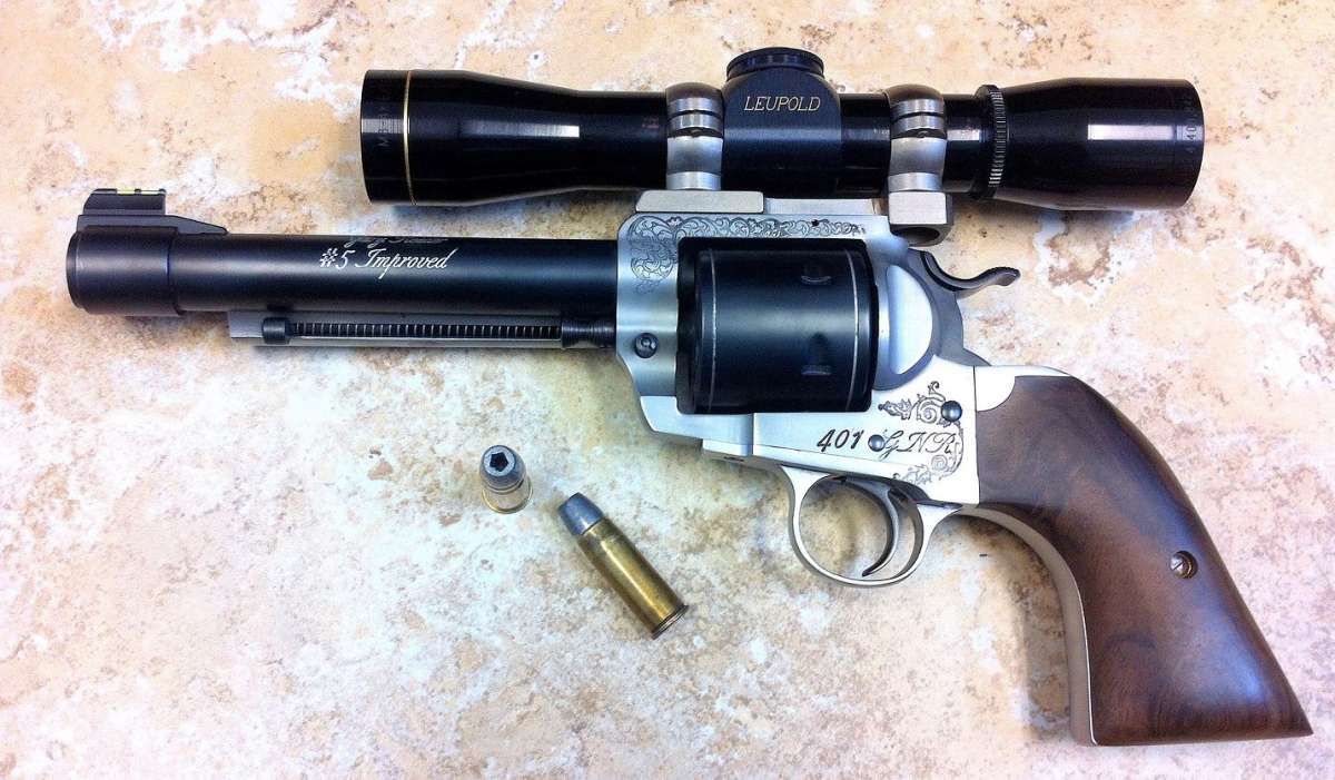

As to the .38-40 it is more tricky than the .44 WCF. I gave up on the .44 Colt Frontier barrel onto the OM Ruger like Taffin managed. Could never get the 2nd generation threads to match acceptably. So I just had Gary do me a 6-shot .38-40 on the old .357 Ruger chassis. It is a delight. I also have a larger chassis 6-shot in .401 GNR with an extra .40 S&W cylinder. Then a .401 Herter's with it's second .38-40 cylinder. The latter is actually, cylinder wise, not much if any bigger than the old Colt Peacemaker. The frame if beefy indeed. Dick Williams once borrowed the Herter's for an article on the .401 Herter. You can still find it on the net and a reference to Gary Reeder working over the .38-40 cylinder!

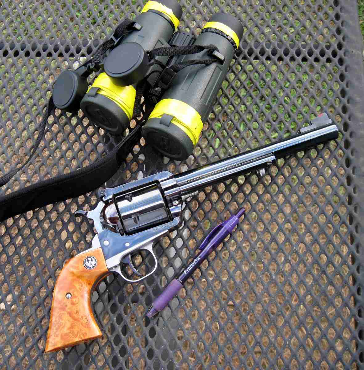

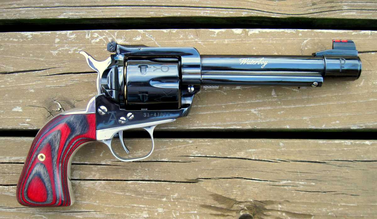

I cheated. Not an original idea, this guy
- WB, 2018-10-19, 16:46
3RD GEN THREADS FIT RUGERS (nm)
- JT, 2018-10-20, 08:13
