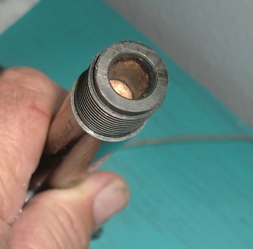

They run a screw into it and pull it, normally. Lead is a lot easier to slide over steel than copper is. Look at the copper fouling in the breech end of the barrel.
![[image]](images/uploaded/201903242313025c980efeb5ca9.jpg)

Could you heat the barrel
- Grover Sr, 2019-03-24, 14:47
I kinda doubt it ... if there was only 1 bullet maybe ..
- Jim Taylor, 2019-03-24, 14:56
remove the barrel and press them out or driil them out (nm)
- Woody, 2019-03-24, 15:08
I have the barrel off the gun ..
- Jim Taylor, 2019-03-24, 15:30
- The right choice to me would be just - Sid R, 2019-03-25, 04:51
I'll never understand just quite how that happens... (nm)
- ChrisG, 2019-03-24, 15:52
bullets
- Alcorn, 2019-03-24, 16:27
- Appear to be FMJ's .. not sure if plated type or not. (nm) - Jim Taylor, 2019-03-25, 06:59

That would work .... hard to drill through 4" of bullets
- Jim Taylor, 2019-03-25, 06:58
- Like the 303 British barrel with an 8mm Mauser bullet... - Huey, 2019-03-25, 07:37

Hope previous owner never gets a 454 Casull... (nm)
- Huey, 2019-03-24, 16:37
- I disagree, firm believer in the - Grover Sr, 2019-03-24, 18:01
