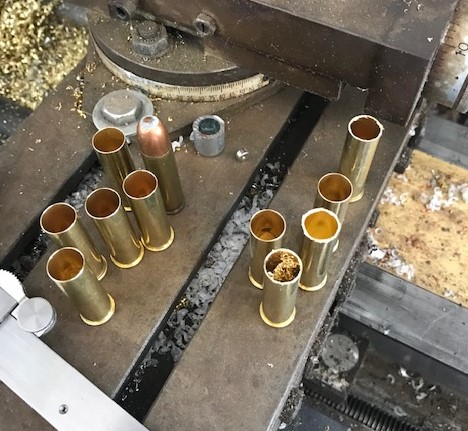

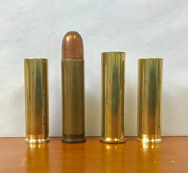

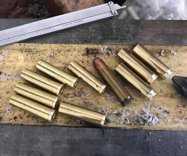

Thanks to a good friend, who specializes in pink boxes, I have a little stash of .414 Elgin T. Gates brass from Starline. Rare as it is, it is not as rare as good usable .401 WSL. I first trim to length, and turn the rims down in diameter so they will fit inside the single stack magazine. BTW good magazines that hold only 4 shots run about $200 on average, if you happen to find a dusty case of them at a yard sale! Lastly, a recess in the solid web must be made so the extractor has a place to "clip" into. I may later have to trim the web to fit a tighter shell holder, for now this will work. I have shot .410" projectiles but really need a .406" bullet sizer. The bullets actually mic 0.403" just ahead of the case mouth and crimp. My soft cast bullets will work for now.
![[image]](images/uploaded/201909171933105d8134f67adcd.jpg)
I'm not a good machinist, never was, but now I really can't see. I have to mock up one, mark the settings, and run by those. With grabby brass it is challenging. I only make a few for fun and testing. It's good, I have not injured anyone today, knock wood.
![[image]](images/uploaded/201909171924225d8132e666ebb.jpg)
