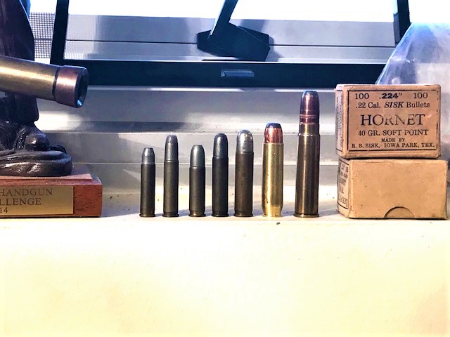

Can you name all the cartridges?

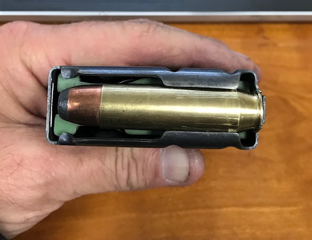

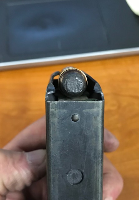

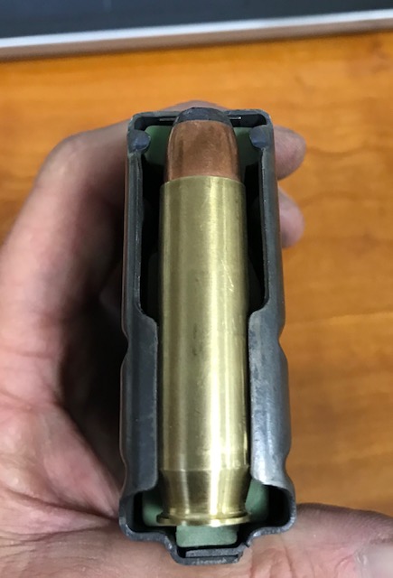

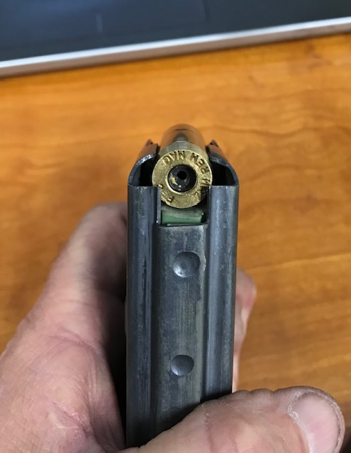

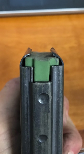

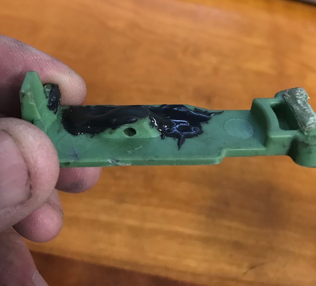

I'm using Palmetto guns and BCA barrels, very conscious of rules and regulations. My latest was a .450 Bushmaster pistol. I chose it over the .458 SOCOM or .50 BW since it uses .45 Colt bullets and has superior performance with bullets from 185-405 grs. I had no cartridges so while I waited on parts and components I mocked one up from a 7mm Rem. Mag. altered on the lathe and using a 405 gr. JSP bullet (yes it can be re-sized to .452" easily). They have magazines for sale at fair prices, aftermarket followers too. I wanted to see if I could modify a standard 20 rnd. 5.56 follower to work. I didn't alter the mag, just the glass filled plastic follower. I have both on hand.
![[image]](images/uploaded/201912161829365df7cd103ddde.jpg)
![[image]](images/uploaded/201912161830185df7cd3a48ab4.jpg)
Grinding the top hump off to make a flat top follower would create holes on the right side of the follower. It is to become a single stack mag with the fat cartridges. So I fulled in the bottom cavity with JB weld. This worked fine. I don't think I lost any integrity and it's not that stressed a part anyway. This is not a combat gun nor serious hunting rig, it's for fun mostly. I'll get a more suitable mag later after the project comes together. This is just some tinkering. I'm only out a 7mm case and a $1 follower.

No one tried to guess the ctgs... (nm)
- WB, 2019-12-16, 15:11
Right 4 ctgs
- Derek, 2019-12-16, 18:02
- You got the ones on the right... - WB, 2019-12-16, 18:50
