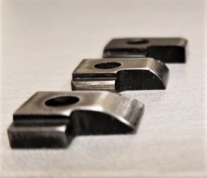

I also read John Browning originally designed the firing pin stop plate, the little sliding plate at the back of the slide the pin protrudes from, with a flat bottom. About 99% of all 1911's today have a beveled bottom. I read that the military demanded a change to assist military trainees rack the slide easier with a "hammer down" condition. I have never heard this before. The idea is this helps provide resistance in keeping the slide locked or closed a bit longer as cartridge pressures peak and drop, and reduces the slide velocity and forces. It was a deviation from the original Browning design to add the bevel. In addition a stiff hammer mainspring, housed in the mainspring assembly under the grip safety on the back-strap, is said to help the hammer hold the slide as well as give added resistance for that "flat" firing pin stop at the back of the slide.

The reading I found was not overly profound in concept but collectively seemed pretty reasonable. I decided to explore it a bit and plan on setting up this 1911 a bit differently than mainstream. My personal goal is to set the gun up for a 200 gr. cast bullet at around 1200 fps, AND have it where I can actually chamber a round with some finger arthritis flaring up. This was the original Bren Ten and Norma 10mm loading.
My plan; Install a more conventional recoil guide system and plug with a #18-20 lb. "flat" wire recoil spring. Swap out to a "flat bottom" firing pin stop plate at the back of the slide. I reflected that I normally cock the hammer manually anyway before racking the slide. Finally add a 23-25# mainspring, I like a snappy hammer anyway. I'll change out firing pin and plunger springs while I'm at it too. The leaf trigger spring feels OK for now. I have lots of smoothing to do on the inside. I may leave the outside rough for a carry, hunting gun. There are times I carry in the woods, and while the .45 is likely plenty, I like the idea of having a like weight solid bullet at a few hundred fps more. Two extra rounds are nice too.
