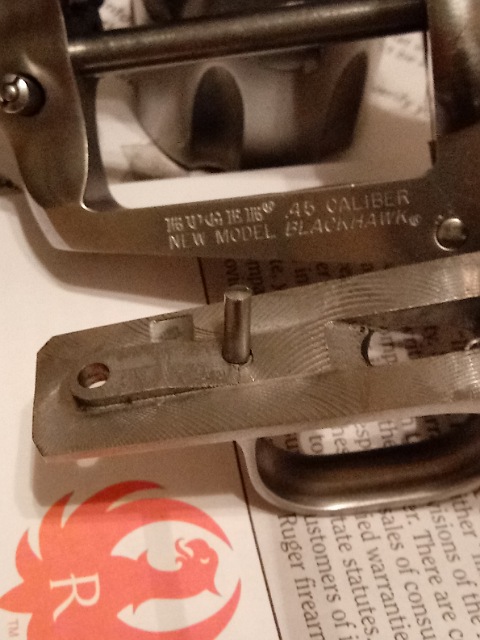

![[image]](images/uploaded/202008231507565f42864c20f29.jpg)
The pin won't fit down in the hole. Either oversize pin or undersized hole.
Sad thing is, it worked fine until I come along.
Do the old models have the same arrangement? Have a beat up 357 here I might try to swap if so.
Ruger BH cylinder stop pin

JB is it just me but when I enlarge
- Grover Sr, 2020-08-24, 09:23
- Hadn't noticed that. I'll report back - JB, 2020-08-24, 23:52
take a small screwdriver and ream out the hole lightly
- gary reeder, 2020-08-23, 16:50
- Screwdriver helped some, then remembered - JB, 2020-08-23, 19:53
- No the OM's had different internals (nm) - Asa, 2020-08-23, 14:03
- Also tends to be real sharp, might be catching a burr. (nm) - Asa, 2020-08-23, 09:28
If it fit before, the pin is probably just a bit...
- Huey, 2020-08-23, 08:24
- upside down is no go - JB, 2020-08-23, 09:43
