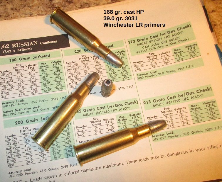

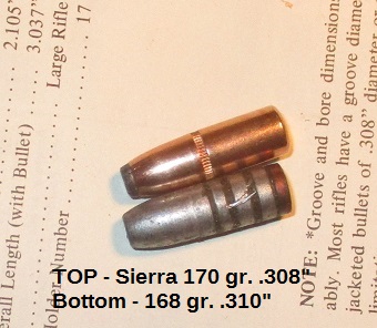

Using a 168 gr. cast hollow point and some Sierra 170 gr. JFP .30-30 bullets.
![[image]](images/uploaded/202011180135465fb47a72b8f6c.jpg)
The cast bullet loads.
![[image]](images/uploaded/202011180136145fb47a8e56ac5.jpg)

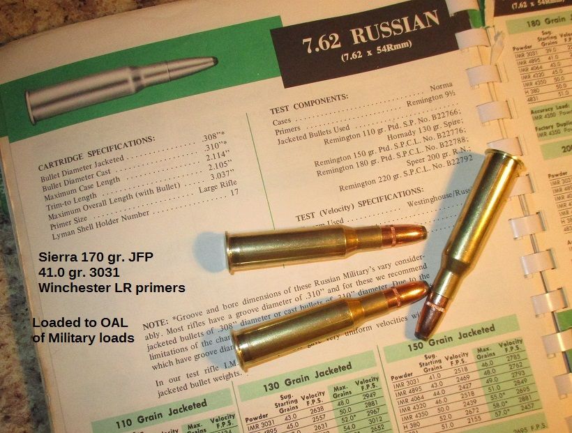

The jacketed bullet loads.

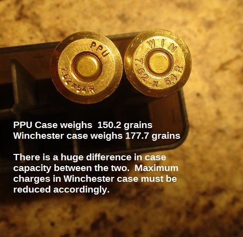

I have PPU brass and Winchester brass. The Winchester brass has considerably less capacity than the PPU. Thankfully the majority of my brass is PPU and it is easy to keep them separated.
