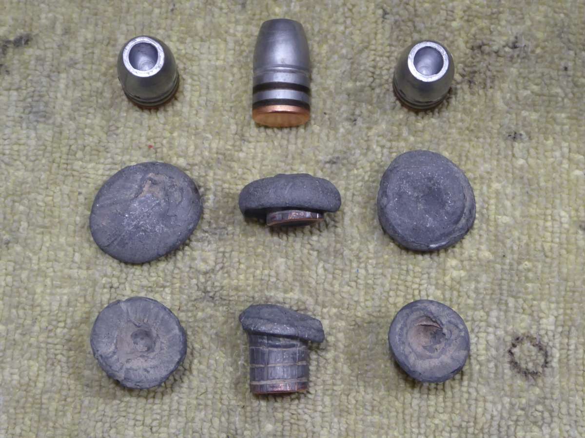

Over the past year or so I've been playing a lot with different alloys for a hunting bullet in the 455 GNR. The mould is a LBT LFN that was hollow pointed by Eric. The original weight of the solid bullet was 310 grs., after H.P'ing bullet weight was 290 grs.
After trying several different alloys I came back to my good old standby of 50% wheel weights and 50% pure. I shot them both air cooled and water dropped. The A.C. gave more expansion than I really wanted and was leaving some lead in the barrel, not enough that accuracy was ever affected, but more than I wanted.
Combined with the too much (for me) expansion and the little bit of leading I tried W.D. I water drop most of my bullets anyway, they just seem to shoot better in the 455 and the H.P. was no exception. But was it going to make them too hard for reliable expansion?
After recovering numerous bullets it looked as if they were going to do what I was looking for. The top row is obviously the original bullet, middle is the A.C. and bottom is the W.D. Of all the bullets recovered the average weight loss was about 5 grs.![[image]](images/uploaded/20221019151156635013bc9cc34.jpg)
