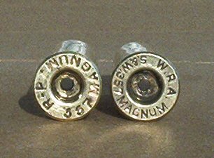

There is some reason, however, to at least (in principle) agree with those who are hesitant about the use of the .357 on Big Game. First, the factory loadings today are loaded to less pressure than the original loads and consequently have less power. The early .357's were loaded in cartridges that utilized a Large primer and heavy loads developed quite a bit of pressure above the established levels of today's factory offerings.
![[image]](images/uploaded/20230306002827640533ab770ce.jpg)
Second, it is a .35 caliber pistol and as such the shots must be placed on the game very carefully. A lot of those who take to the field these days are not experts either in hunting or shooting. In the field a person must know when and when not to take a shot... or as the movie line goes, "A man has to know his own limitations." Unfortunately many do not and if they read that so-and-so used "this" or "that" to bag his trophy they figure they can too.

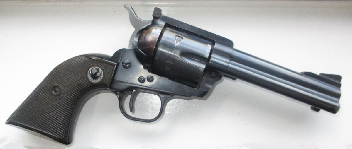

It's 2021 and it has been some years since I've had a .357 Magnum single action. Earlier in my life I concentrated on the .45 Colt and later the 454 Casull and .475 Linebaugh. Those days are past and I just don't enjoy shooting the heavy recoiling stuff anymore. I started shooting .38 Specials in the S&W Model 10 and really liked it. And it got me to thinking about possibly getting a .357 single action again.
One day a friend sent me a flyer. He was handling the estate of someone who had passed and was selling his guns. Listed among all of the various guns were a couple of 4 5/8" Ruger .357 Magnum Flat Top sixguns! To me the old model Ruger .357 Flat Top is just about the epitome of a sixgun. Small, but large enough to handle almost anything you are gonna need it for. It is basically the same size as the Colt SAA with better steel, better springs and better sights.
I immediately contacted him and put in a bid on one of them. And got the gun! When I finally had it in my hands I was really tickled. While you can see it had been used some ... it is 63 years old! ... it did not appear to have done much if any time in holster. It was not beat up. The screws were clean and not boogered. The barrel/cylinder gap is tight and it locks up correctly with no end-shake. I even had several proper size holsters in my stash of stuff. It was like I had gone full circle. I was back where I started with centerfire sixguns!
