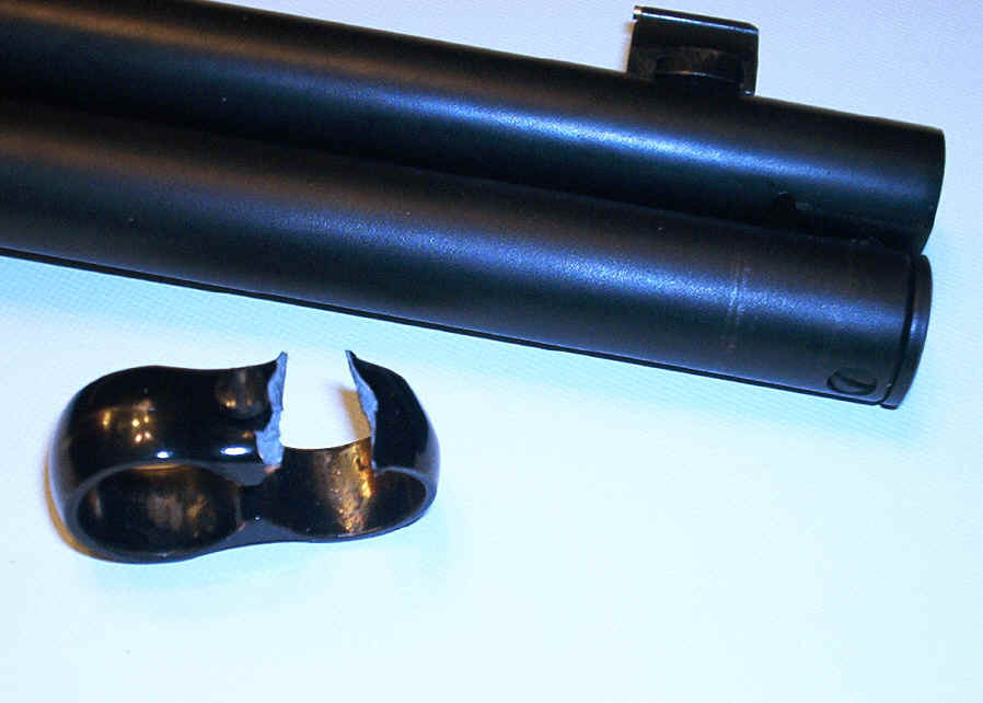

When the packaged arrived it was easy to see this was a rifle of some sort. Unpacking it I found a Winchester 30-30 Trapper of early 1980’s vintage. Inspection revealed the barrel band was blown apart but other than that the gun appeared in fine shape. Working the action it felt gritty like it was full of sand. Looking down through the top of the action did not reveal any dirt so I put that off for future inspection.

It turns out my friend had bought the gun used. The finish was worn pretty badly so he took it to a gunsmith in his area for a reblue. When he got it back the gun not function properly. The action was stiff and gritty. He shot it some but was real frustrated with it. During one of his shooting sessions the forward barrel band came loose, swung in front of the bore and not noticing it, the next shot he fired blew it apart. By this time he was really frustrated with the gun and decided to get rid of it. He did not feel right about selling it and knowing I liked to tinker with guns he decided to make a present of it to me!

I started looking around for a barrel band and found a friend in Colorado who had a bunch of them. He was kind enough to send me what I needed. While waiting on the barrel band I stripped the gun to see if I could figure out what the grittiness came from. Imagine my surprise at finding the gun full of bluing salts residue! There was residue on the loading gate, on the frame rails, around the screw heads and in the spring detents. Whoever had blued the gun did not do a clean-up job on it.

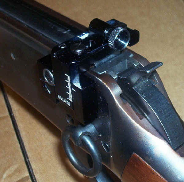

While waiting on the barrel band I went online to Brownell’s website and ordered a Williams 5D aperture sight. I like “peep” sights on my leverguns. This would not be a gun for target use so I did not need the fine adjustment of a sight such as the Fool-Proof model. A “fixed” sight would work just fine. The 5D is adjustable and once adjusted to the load I will use I will lock it down and leave it. I also plan to use the sight as a "ghost ring".

Back in the shop it took some time to diagnose the problem but eventually I figured out that it was a carrier timing problem. I stripped the gun and re-cut the carrier (lifter) and that was that! Now it fed flawlessly as fast as you could lever it. The Williams sight had arrived and I took the time to install it. Then it was back to the range to get it sighted in. That was fairly painless and in no time the Trapper was ready for duty.
