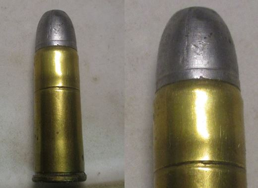

18.5 gr. 2400 ... standard primer .. using bullet #457191
![[image]](images/uploaded/20250627223534685f1cb6d71d7.jpg)
I don't neck expand. I use a tapered rod to just flare the lips of the case enough to start the bullet. Extra case tension helps stop bullets from pulling the crimp.
