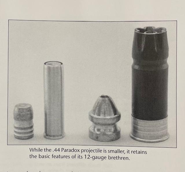

the unfluted cylinder re-bored straight through to hold a flush .460 S&W case. The barrel is still the original .44 but has a 3-1/2" smoothbore .45 section, a sort of engineered transition or throat, into the .430" section. The bullets do get longer as they are reformed in the bore, and I'm certain it is a little rough but not much more than the cylinder/throat transition. Excepting forcing a .45 into a .44.
They call it a .44 Paradox, but the case (.460 S&W) and bullet are literally .452". But indeed, when the smoke clears, a .44 projectile is what is in play. Just not in the beginning.

![[image]](images/uploaded/20250628132709685fedad8a32b.jpg)
I have a 300 gr. .45 Colt Ruger load to do.

This is actually the .45 Paradox loading.
