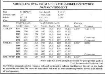

This is a mistake. The gun loaded to under 20,000 psi matches or exceeds 500 Linebaugh revolver ballistics. Think the 500 Linebaugh won't kill big game?
I've attached some published loading data for reference.
