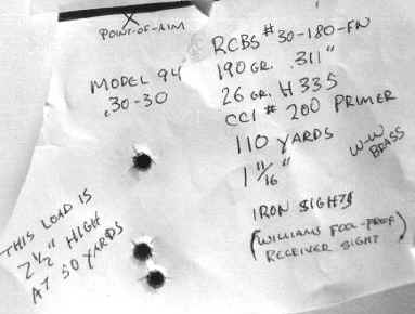

and used it to clean a Model 94 Winchester of copper fouling and lead fouling. Took me several days to get the barrel absolutely clean.
On the range I could barely keep the shots inside 6" at 25 yards and the "groups" walked around the paper. It took over 100 rounds to get the barrel to settle down and shoot.
This is one of the targets after it settled down .. my old cast bullet load. Fired at 110 yards.
