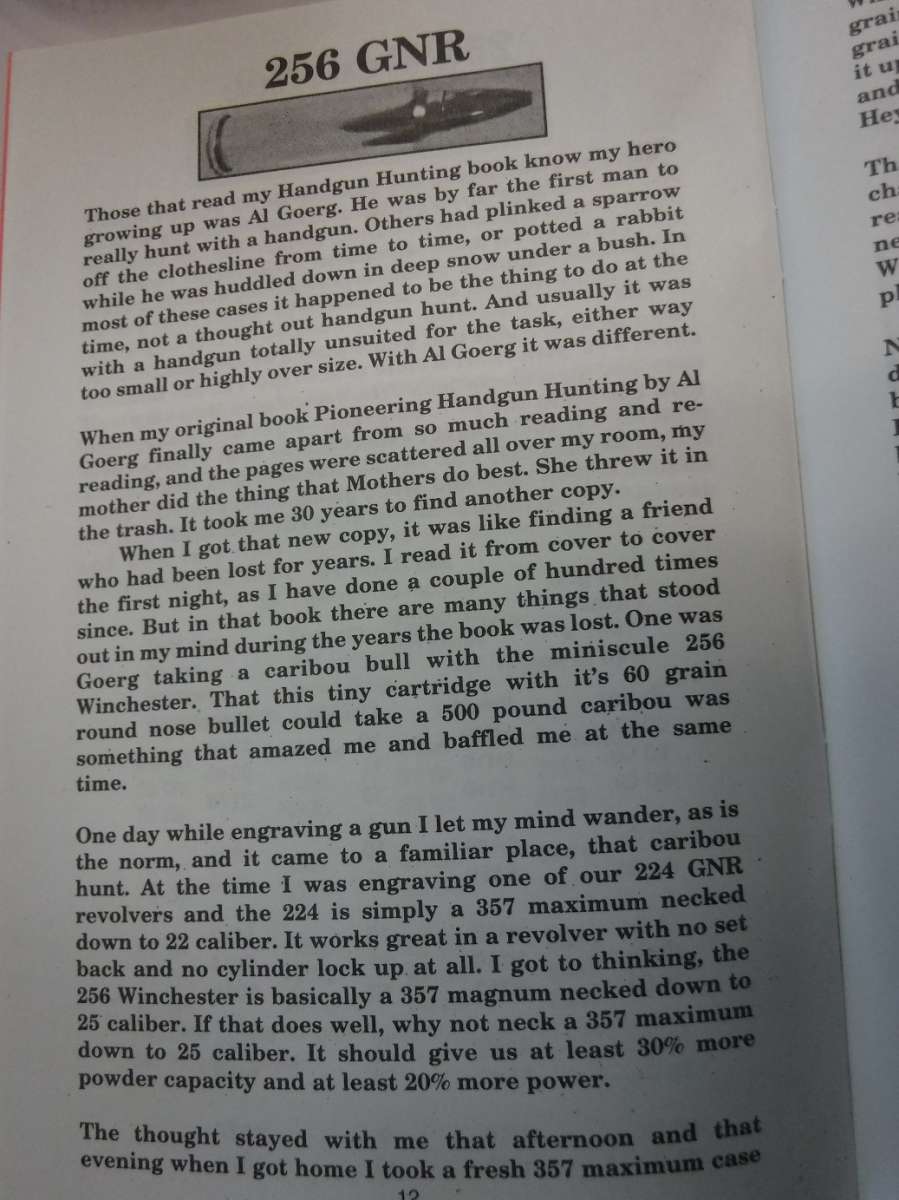

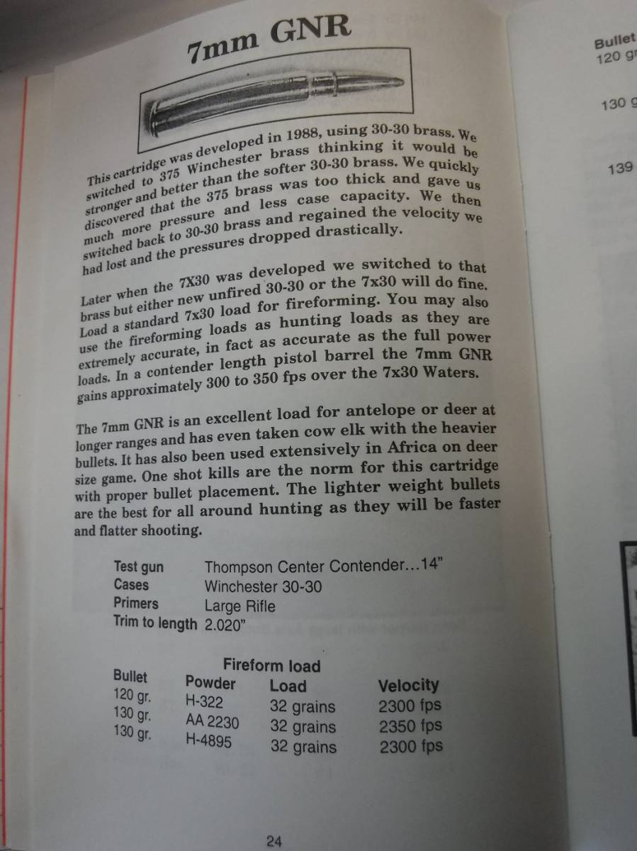

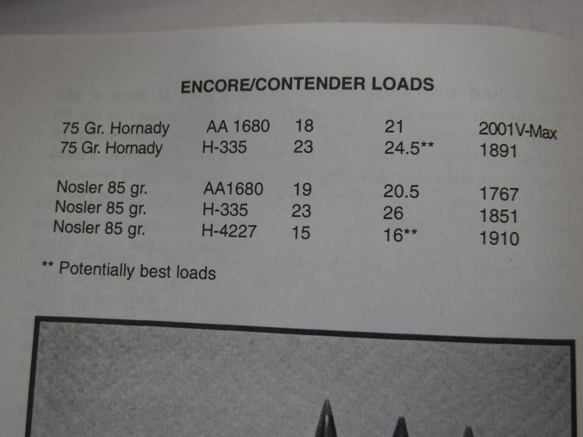

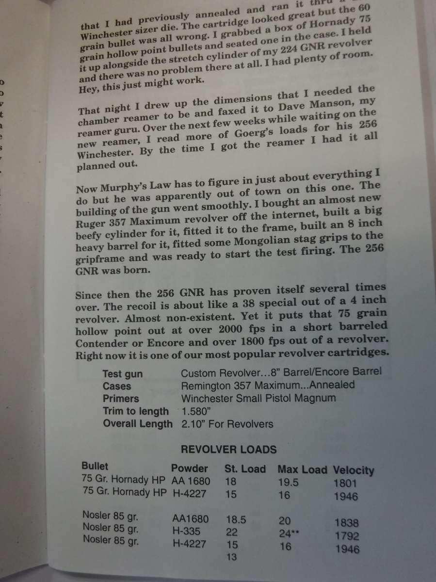

for the 256 GNR..
![[image]](images/uploaded/201908291954495d682d89c4465.jpg)
![[image]](images/uploaded/201908291955135d682da1c87f2.jpg)
![[image]](images/uploaded/201908291955355d682db74128d.jpg)

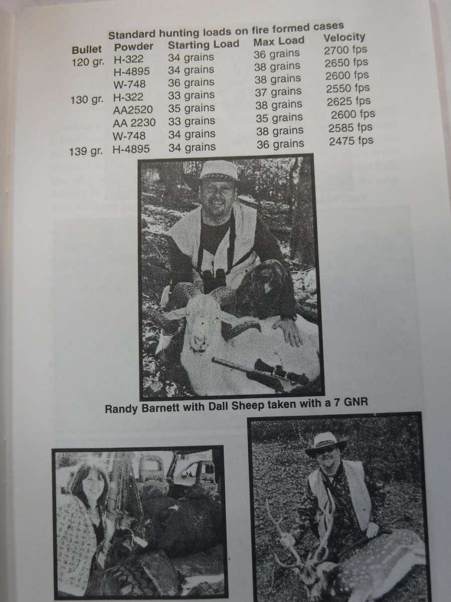

As Scotty said above the 7 GNR is more of a do it all cartridge and has been one of our most popular cartridges since day one. Here is the loading data for it from the reloading manual.
![[image]](images/uploaded/201908291956335d682df1b31eb.jpg)
![[image]](images/uploaded/201908291956545d682e0669749.jpg)
