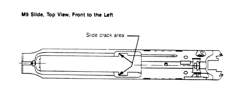

The General Accounting Office report in the 1980's detailed the problems. There were a number of broken guns and injuries to the shooters. The slide would come back and bash your face when it let go.
It would crack here:
![[image]](images/uploaded/202012272022105fe8ecf2490c0.jpg)
I've seen some that were cracked all the way through on one side.
Here's the report:
https://www.gao.gov/assets/110/102286.pdf
