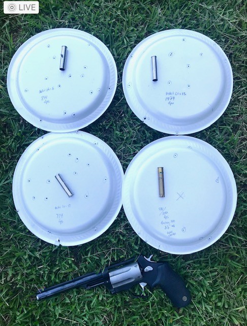

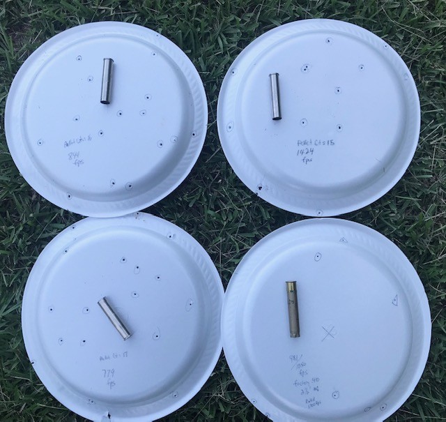

I shot plates at 15 yds. (note do not use wooden oak pallets as backstops - shot myself even at an angle) My loads, while unrefined and raw, totally shamed factory .410 shotshells that cost about $1.50 each. I shot the lower right plate TWICE with factory shotshells, #8 listed at 1300 fps, they averaged 1000 fps. First shot got TWO hits on a 8" plate at 15 yds! Second shot only added 6 more. Totally crap and worthless except maybe 10-15 ft. Or clearing the deck of a Pirate ship.

I used a mix of #5 & 6 shot a friend gave me. I averaged 16 hits per plate. I do think the velocity was around 800-850 fps, not too far off my prediction given the crimps were not as good as I hoped. Brass is not totally blown out to chamber dimensions. Real snake killers and useful, just need refinement.

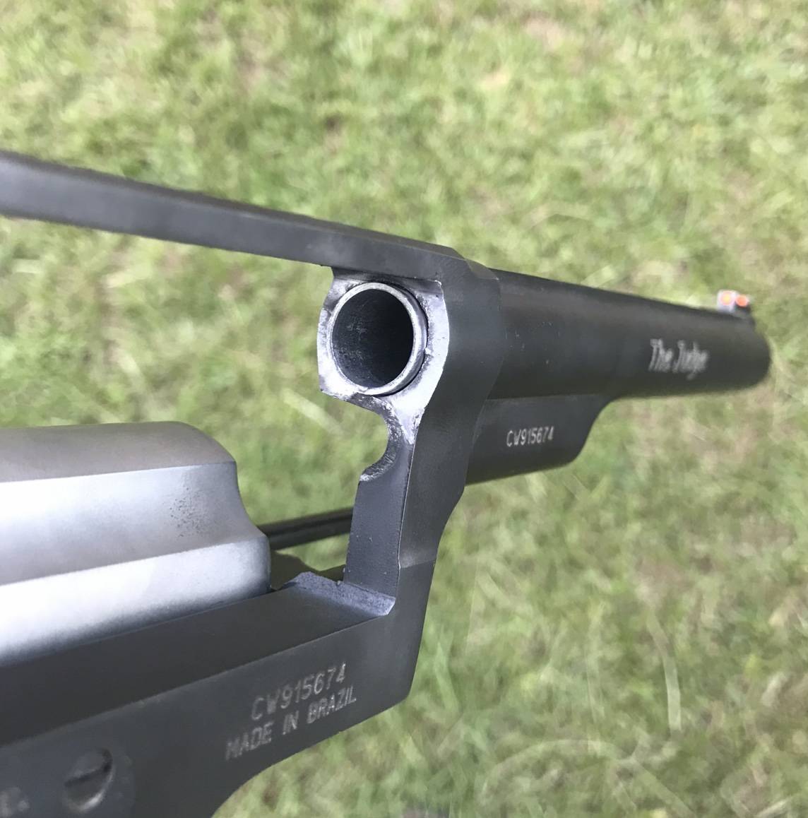

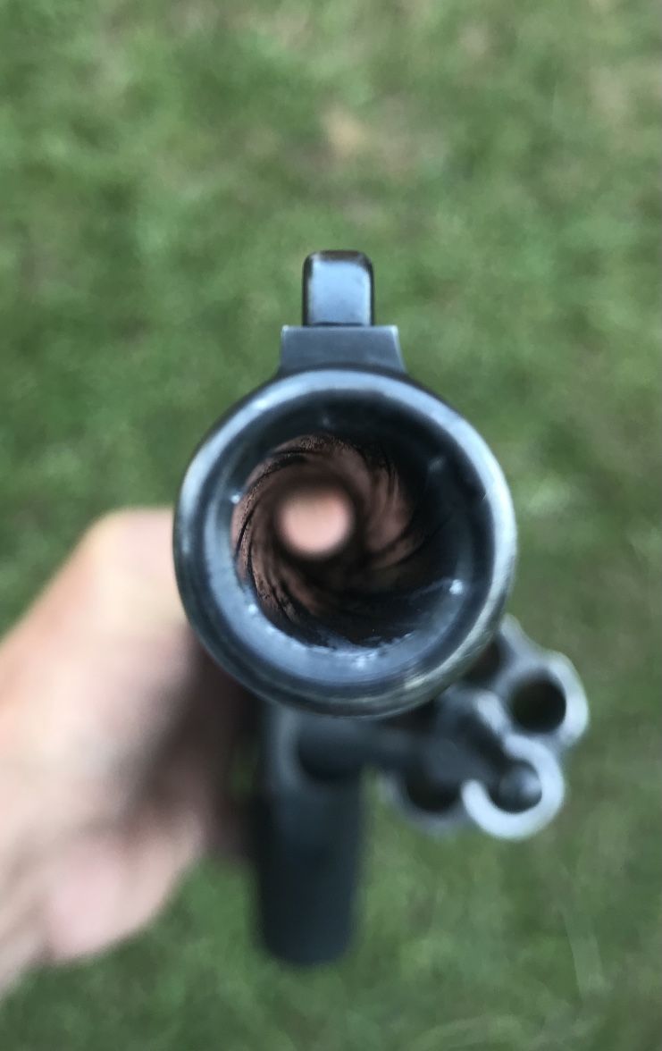

My notes are that I need a more solid or thicker base wad. The shot really greased the forcing cone with lead too, what a mess. I'm thinking a .410 plastic wad would be a useful addition. The bore is greased with lead too. I'd rather clean out plastic fouling over lead any day.
