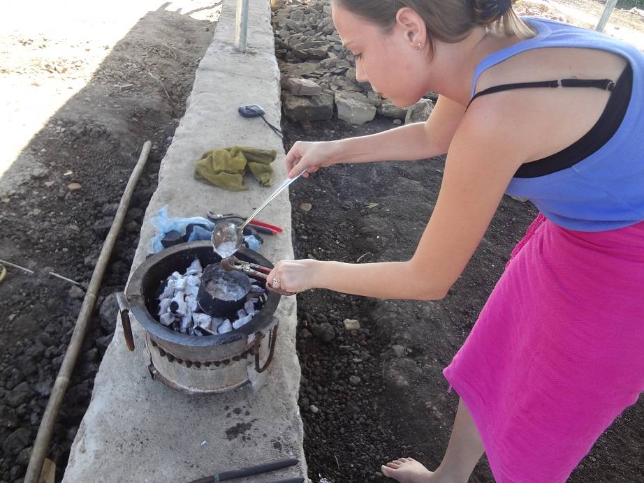

You can get started with very little. In Africa I melted the lead on a charcoal fire, dipped it out with a large spoon to cast 30 caliber round balls for the Wrist Rocket Sling shots. Here is one of the missionary kids casting 30 caliber round balls for her sling shot. She was deadly with it.
