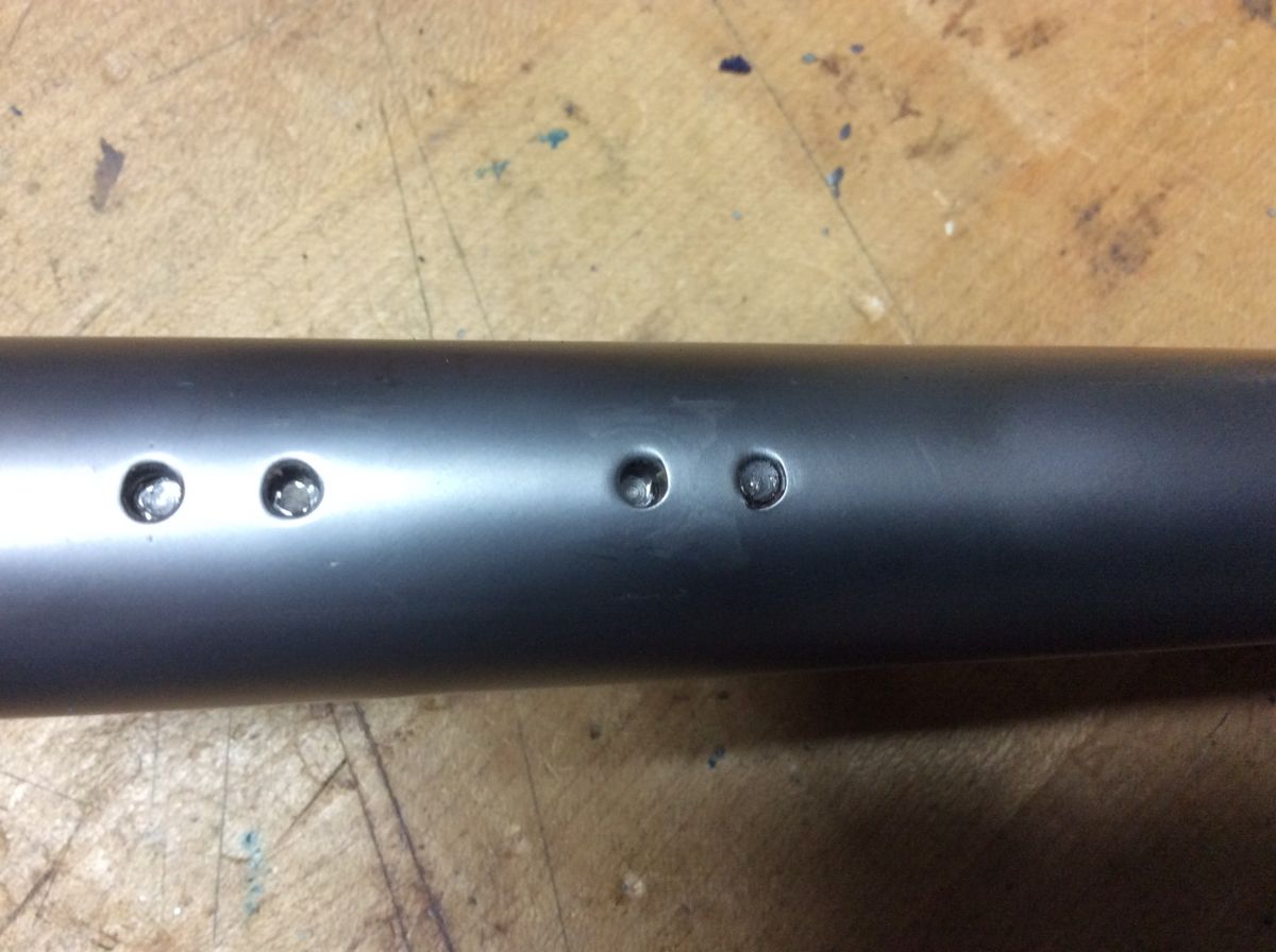

Scope base mounting screw? Forward hole screw just twisted in half.
I did not use my 5’ cheater bar to torque and it broke. The sight of the bar must have scared the screw.

Usually
- Shawn Davis, 2018-01-31, 22:48
- +1 on the left handed drill bit (nm) - Blake, 2018-02-01, 05:17
- If you do not have access to a machine shop - Larry Fry, 2018-01-31, 21:26
Drill hole in the screw, follow up with easy out. If you....
- Jeff Spencer, 2018-01-31, 20:05
- Yes a sharp bit and drill press. Whack a divot - WB, 2018-01-31, 21:02
