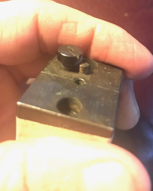

The old pins that survived some other moulds I have use wooden handles with a washer that limits, or makes pin placement consistent. You spin the handle to "lock" the location washer against the pin on the mould and under the lip on the mould bolt.
I'll need to tinker to replicate this on some level.
![[image]](images/uploaded/2021022023472760319f8f6a10c.jpg)
What are the thought on metal for a HP pin in a mould?

- The meplat is about 0.246" and hole 0.115" - WB, 2021-02-20, 17:31

Plug it and make a nice flat point bullet. (nm)
- Jim Taylor, 2021-02-20, 16:35
that is what I would do. A 338 bullet doesn't need to be
- Gary Reeder, 2021-02-20, 16:48
At lower velocities it can become a Partition
- WB, 2021-02-20, 16:57
