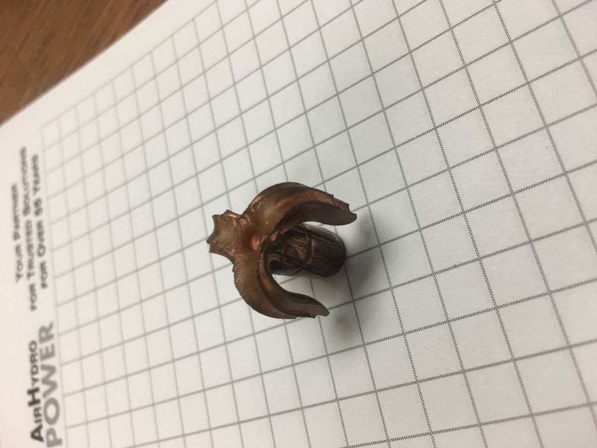

What are the thought on metal for a HP pin in a mould?
- WB, 2021-02-20, 16:30

- The meplat is about 0.246" and hole 0.115" - WB, 2021-02-20, 17:31

Plug it and make a nice flat point bullet. (nm)
- Jim Taylor, 2021-02-20, 16:35
that is what I would do. A 338 bullet doesn't need to be
- Gary Reeder, 2021-02-20, 16:48
At lower velocities it can become a Partition
- WB, 2021-02-20, 16:57
Sir Boggs. If you want a partition
- Bob denning, 2021-02-20, 18:19
You mentionte that, heat with a propane torch first?
- WB, 2021-02-20, 18:23
- Preheat - Carl L, 2021-02-20, 22:46
