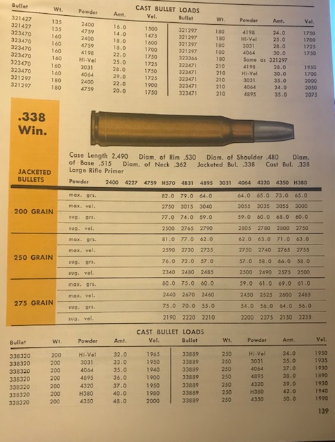

So that means the lead is about 65 thousandths thick at the nose. I really don't want to make the hole bigger. The Lyman 33889 I thought was a much older design for the .33 Winchester but no. It was designed in 1960 actually for the .338 Winchester Magnum. The Penta HP pin will be a tricky one! LOL
I got an ancient Lyman manual from Gary some time ago. Another Estate sale I figure. A man's name was on the book "J.M. Whitehall - Sept' 61. That was 2 years and 9 months BEFORE I was born some 58 yrs. ago (me). Back then the Lyman manual shows a top velocity just under 2000 fps using 50 grs. of 4350 powder. Today I have powder coating and even slower powders available to me. Can I get another 500 fps with no leading?! Will it be accurate? The fun begins!
