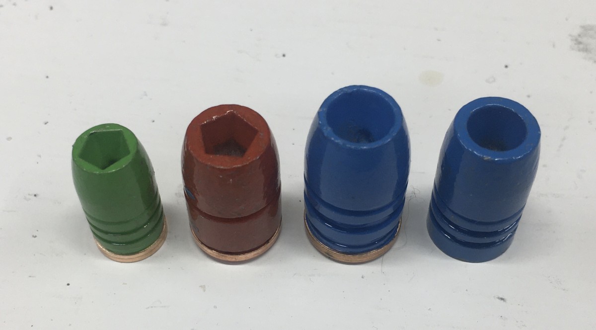

I really favor the penta pins.![[image]](images/uploaded/202102210004456031a39d59935.jpg)
What are the thought on metal for a HP pin in a mould?

I would go about 500”

- The meplat is about 0.246" and hole 0.115" - WB, 2021-02-20, 17:31

Plug it and make a nice flat point bullet. (nm)

that is what I would do. A 338 bullet doesn't need to be

At lower velocities it can become a Partition

- That will be one of the first made. - WB, 2021-02-20, 16:48
